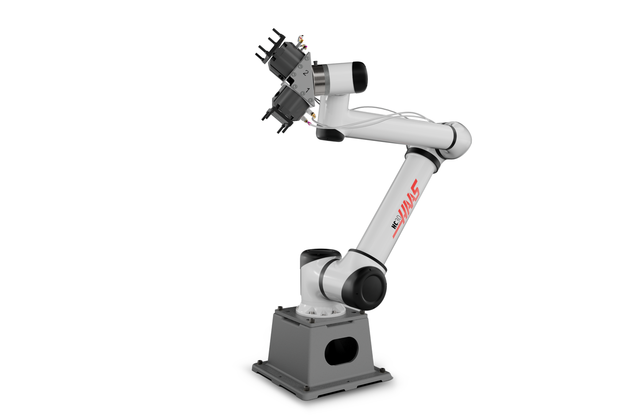

30 kg
Capacity
222 mm
Max Part Dia.
1800 mm
Reach
6
All-in-one cobot kit for your new machine! The Haas 30 kg Cobot Package includes everything required to run your new cobot directly from the Haas control. This kit features the HC30 Cobot with a 30 kg capacity, dual pneumatic grippers, protective barriers, a temporary mounting base*, a parts table, a part flip station, and all necessary hardware and cables.
*Does not ship pre-built. The temporary mounting base is for optional use, and is not included in Europe. Floor mounting is recommended. Cobot carries a one-year warranty.
N.B. Specifications subject to change without notice.
AXES | S.A.E | METRIC |
Controlled Axes | 6 | 6 |
CAPACITIES | S.A.E | METRIC |
Max Load Capacity at Wrist | 66.0 lb | 30 kg |
Reach | 70.9 in | 1800 mm |
Repeatability | 0.0020 in | 0.050 mm |
DUAL GRIPPER | S.A.E | METRIC |
Max Part Weight (per gripper) | 19.8 lb | 9.0 kg |
Gripper Assembly Weight | 26.4 lb | 12.0 kg |
Part Size - Round ø | 0.63 in to 6.00 in | 16 mm to 152 mm |
Part Width - Rectangular | 0.51 in to 6.00 in | 13 mm to 152 mm |
MOTION | S.A.E | METRIC |
Motion Range – J1 | 360 ° | 360 ° |
Motion Range - J2 | 200 ° | 200 ° |
Motion Range - J3 | 160 ° | 160 ° |
Motion Range - J4 | 360 ° | 360 ° |
Motion Range - J5 | 360 ° | 360 ° |
Motion Range - J6 | 360 ° | 360 ° |
SPEEDS | S.A.E | METRIC |
Max Speed - J1 | 120 °/sec | 120 °/sec |
Max Speed - J2 | 120 °/sec | 120 °/sec |
Max Speed - J3 | 120 °/sec | 120 °/sec |
Max Speed - J4 | 180 °/sec | 180 °/sec |
Max Speed - J5 | 180 °/sec | 180 °/sec |
Max Speed - J6 | 180 °/sec | 180 °/sec |
GENERAL | S.A.E | METRIC |
Mounting Method | Pedestal Mount | Pedestal Mount |
Wrist Flange Mounting Type | ISO 9409-1-50-8M6 | ISO 9409-1-50-8M6 |
