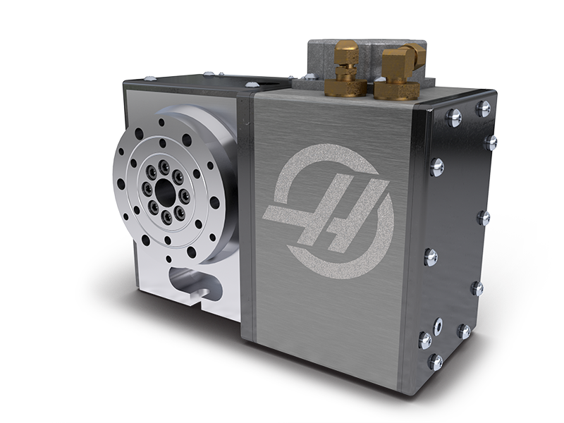

210 mm (8.3″) Servo Rotary Table. Requires Haas mill with 4th-axis drive for full 4th-axis operation, or a rotary control box for stand-alone operation. Requires a Haas mill with software version 18.00 or later.
SPINDLES
COLLET SIZE
MAX TORQUE
MAX SPEED
| HRT210 | ||
| Platter | S.A.E. | METRIC |
| Diameter | 8.3 " | 210 mm |
| Number of Std T-Slots | 6@ 60° | 6@ 60° |
| Spindle | S.A.E. | METRIC |
| Max Speed | 0.001 to 100 °/sec | 0.001 to 100 °/sec |
| Max Torque | 210 ft-lb | 285 Nm |
| Runout Max | 0.0005 " | 0.013 mm |
| Backlash | 30 arc-sec | 30 arc-sec |
| Through Bore | 2.0000 (+0.0005 -0) " | 50.800 (+0.013 -0) mm |
| Center Height | 6.000 ± 0.001 " | 152.40 ± 0.03 mm |
| Gear Ratio | 90:1 | 90:1 |
| Timing | 2:1 | 02:01:00 |
| Brake Torque @ 100 psi/6.9 bar | 200 ft-lb | 271 Nm |
| Indexing | S.A.E. | METRIC |
| Max Rotation/Step | 999.999 ° | 999.999 ° |
| Resolution | 0.001 ° | 0.001 ° |
| Accuracy (±) | 15 arc-sec | 15 arc-sec |
| Repeatability | 10 arc-sec | 10 arc-sec |
| Worm Gear Dia | 6.3 " | 160 mm |
| GENERALS | S.A.E. | METRIC |
| Power Requirement | 115 VAC ± 10% @ 15 A | 115 VAC ± 10% @ 15 A |
| Air Pressure Max | 150 psi | 10.3 bar |
| Operating Temp (max ambient) | 100 °F | 38 °C |
| Duty Cycle full/low speed | 50/100 % | 50/100 % |
| Weight | S.A.E. | METRIC |
| Brushless Control | 14.2 lb | 6.4 kg |
| Table | 165 lb | 74.8 kg |
