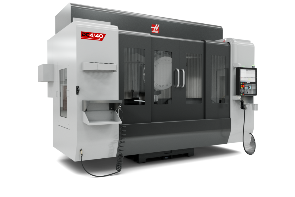

The DC-4/40 is a gantry style drill and tap machine with 2,500 mm of X-axis travel, designed to handle long, narrow parts or high density production setups. The gantry mounted spindle head travels in the X and Z axes, while the table moves in the Y-axis and is fully supported along its length to accommodate heavier workpieces.
A 10,000 rpm, 40 taper spindle and high speed, 20 tool turret style tool changer help minimise tool change times and reduce cycle times. Optional 12,000 rpm and 15,000 rpm spindles are available for even greater productivity.
Ideal for the construction, automotive and aerospace industries, the DC-4/40 can machine parts up to 2,500 mm long and 500 mm wide, including extrusions, steel channel, angle iron and pipe.

DC-4/40 high speed drill centre; 2,500 x 500 x 300 mm, BT40 taper, 11.2 kW inline direct drive spindle, 10,000 rpm, 30.5 m/min X-axis rapids, 35.6 m/min Y and Z axis rapids, high speed 20 tool turret style tool changer, early power failure detection module, 1 GB program memory, Haas control widescreen display, USB port, Ethernet and WiFi connectivity, memory lock keyswitch, rigid tapping, 568 litre flood coolant system with multi stage coolant pump.
