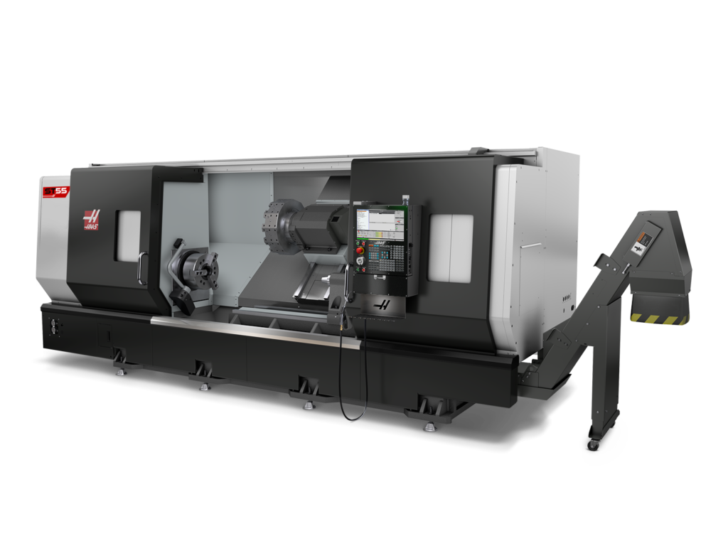

The Haas ST-55Y is a Y-axis version of our large-bore ST-55 turning centre, providing the same heavy cutting ability, extreme rigidity, and high thermal stability, while adding Y-axis and C-axis motion for secondary operations. The twin-chuck capability, high-torque spindle, and large through-bore make the ST-55Y ideal for machining heavy pipes and fittings, large couplers, and long rollers. The addition of Y-axis motion, C-axis interpolation, and live tooling allows milling, drilling, and tapping for increased machine capabilities.
  • 12-station base mount turret (BMT75)
  • Front and rear A1-20 spindle nose with 12.5″ (318 mm) bore
  • ± 3.0″ (76 mm) Y-axis travel
  • Fully interpolated C-axis
CNC Y-axis Lathe, Ø27.5″ x 80″ (699 x 2032 mm) capacity, 7.0″ (178 mm) bar, 55 hp (41 kW) vector drive, 1,000 rpm, 2 speed gearbox, A1-20 spindle, 12 station bolt on turret, ±3.0″ (76 mm) Y-axis travel, programmable servo tailstock, 19″ colour LCD monitor, memory lock keyswitch, USB port, colour remote jog handle and rigid tapping.
