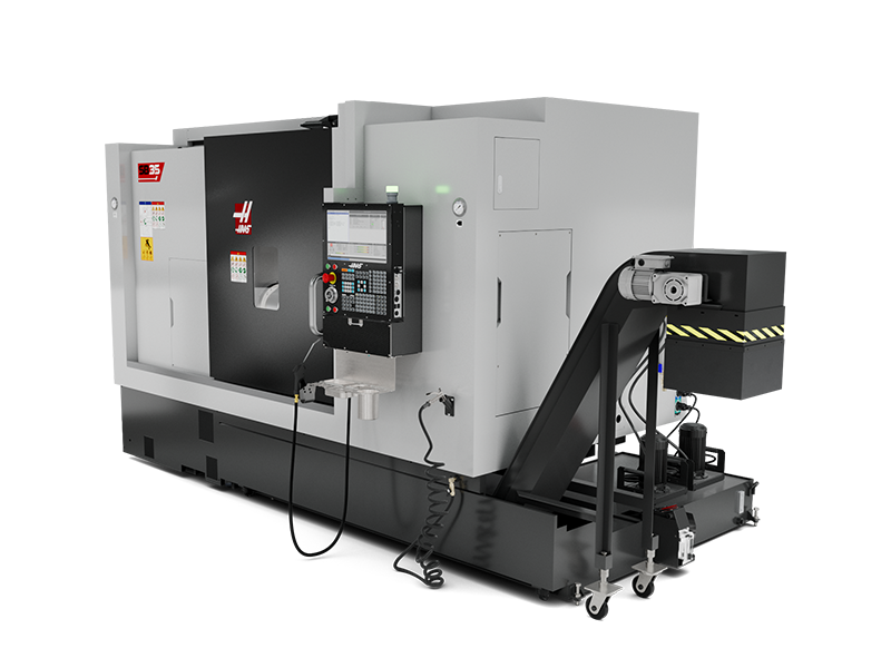

The Haas SB-35 offers the high dynamic stiffness, load-bearing capacity, and vibration damping associated with traditional box way machines, combined with the powerful, easy-to-use Haas control, and backed by industry-leading support.
  • BMT65 turret
  • Hardened and precision ground ways
  • Hand-scraped Turcite-B slideways
  • 30° slant-bed with 30° Y-axis wedge angle
  • Compact footprint
NOTE: The SB-35 is not compatible with the Haas Bar Feeder, and is not available with a parts catcher.
Box Way CNC turning centre, 13.5″ x 30″ (345 x 760 mm) max capacity, 3.50″ (90 mm) bar, 23.6″ (600 mm) swing, 40 hp (29.8 kW) vector drive, 2500 rpm, A2-8 spindle, 12″ (305 mm) chuck, 12-station BMT65 turret, 15″ colour LCD monitor, memory lock keyswitch, USB port and rigid tapping. Standard toolholder kit included with BOT or Hybrid turret.
Not only will your shop be more productive and experience reduced setup times, but the BMT65 Turret and Live Tooling also provide increased cutting performance, longer tool life, and better tool clearance, when compared to older Haas lathe models.
