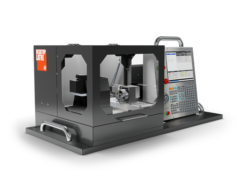

The Haas Desktop Lathe is the ultimate training machine for schools and technical colleges. Powered by a full-function Haas CNC control housed in our portable simulator enclosure, the Desktop Lathe is perfect for teaching the basic principles of programming and operating a CNC lathe. Designed to cut brass, plastics, and machinable wax, it is also perfect for hobbyists and benchtop machinists.
NOTE: Includes 3 wedge clamps and 1 anti-rotation pin. Complete tooling kit available.
N.B. Specifications subject to change without notice.
| CAPACITIES | S.A.E | METRIC |
| Chuck Size | 2.5 in | 63 mm |
| Max Cutting Diameter | 0.75 in | 19 mm |
| TRAVELS | S.A.E | METRIC |
| X Axis | 2.70 in | 69 mm |
| Z Axis | 2.75 in | 70 mm |
| SPINDLE | S.A.E | METRIC |
| Max Rating | 1.5 hp | 1.1 kW |
| Max Speed | 3000 rpm | 3000 rpm |
| TURRET | S.A.E | METRIC |
| Number of Tools | 6 Stations | 6 Stations |
| OD vs ID Tools | 3 OD (6x6x8 mm) / 3 ID (16 mm ) | 3 OD (6x6x8 mm) / 3 ID (16 mm ) |
| GENERAL | S.A.E | METRIC |
| Machine Weight | 265 lb | 120 kg |
| ELECTRICAL SPECIFICATION | S.A.E | METRIC |
| Power Requirement | 110 VAC | 220 VAC @ 20 A | 110 VAC | 220 VAC @ 20 A |
| DIMENSIONS - SHIPPING | S.A.E | METRIC |
| Export Crate | 56.0 in x 37.0 in x 35.0 in | 142 cm x 94 cm x 89 cm |
| Weight | 360 lb | 164.0 kg |
The Haas Desktop Lathe is the ultimate training machine for schools and technical colleges, and perfect for teaching the basic principles of programming and operating a CNC lathe.
Powered by a full-function Haas CNC control, the Desktop Lathe is perfect for teaching the basic principles of programming and operating a CNC lathe.
