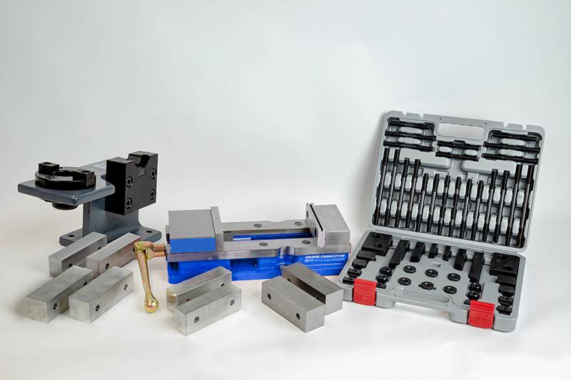

WORKHOLDING:  As with raw material, workholding will vary a great deal, depending on the parts you are machining. For a vertical machining centre, you should at least have a 150mm fixed-jaw vice, a few sets of soft jaws, a toe clamp kit, and some basic hand tools.
As your collection grows, you will want to consider different sized vices, and maybe even dual-station vices. For lathes, a collet chuck may be in order, if you find yourself consistently doing bar work.
